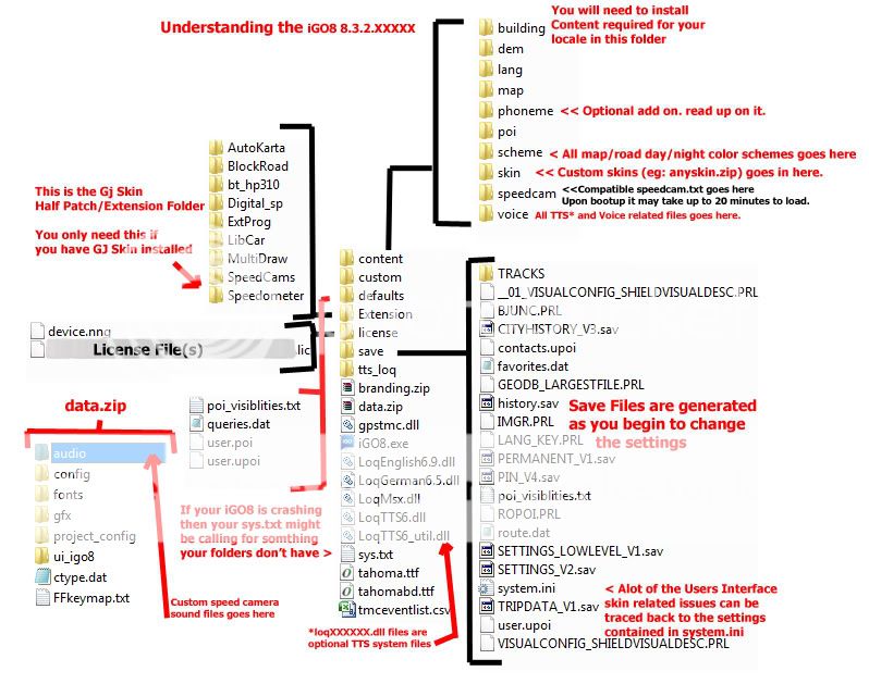

I have been getting some PM's regarding iGO8 issues. so I've made a rough guide so you guys can see what files you might be missing.
For iGO8 to work properly the only folders you could leave empty referring diagram above;
"Save" Folder (It will usually populate as you save settings)
"Custom" Folder (Somehow it's always empty...)
"Phoneme" Folder (Optional Localized pronunciation files)
"Speedcam" Folder (If you have custom speed cam locations here's where you put them... if not keep it empty. one file will automotically populate itself there)
"Skin" Folder (If you are using the default GUI nothing needs to be here... If you are using the GJ skin this is where it goes.)
"Extension" Folder (However you must have stuff this folder as shown if you are using the GJ6.0 skin)
