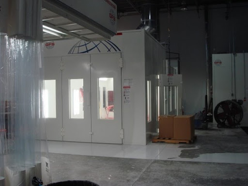

Took the parts to my dads work to use their new spray booth:

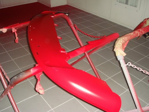

Once the 2ed base coat was given time to flash, 2 coats of SEM Real Clear was applied:
The parts were then baked at 140*F for 20 min with a 10 min cool down time. This was to help cure the finish stronger and faster.
Final parts after baking and cool down:
